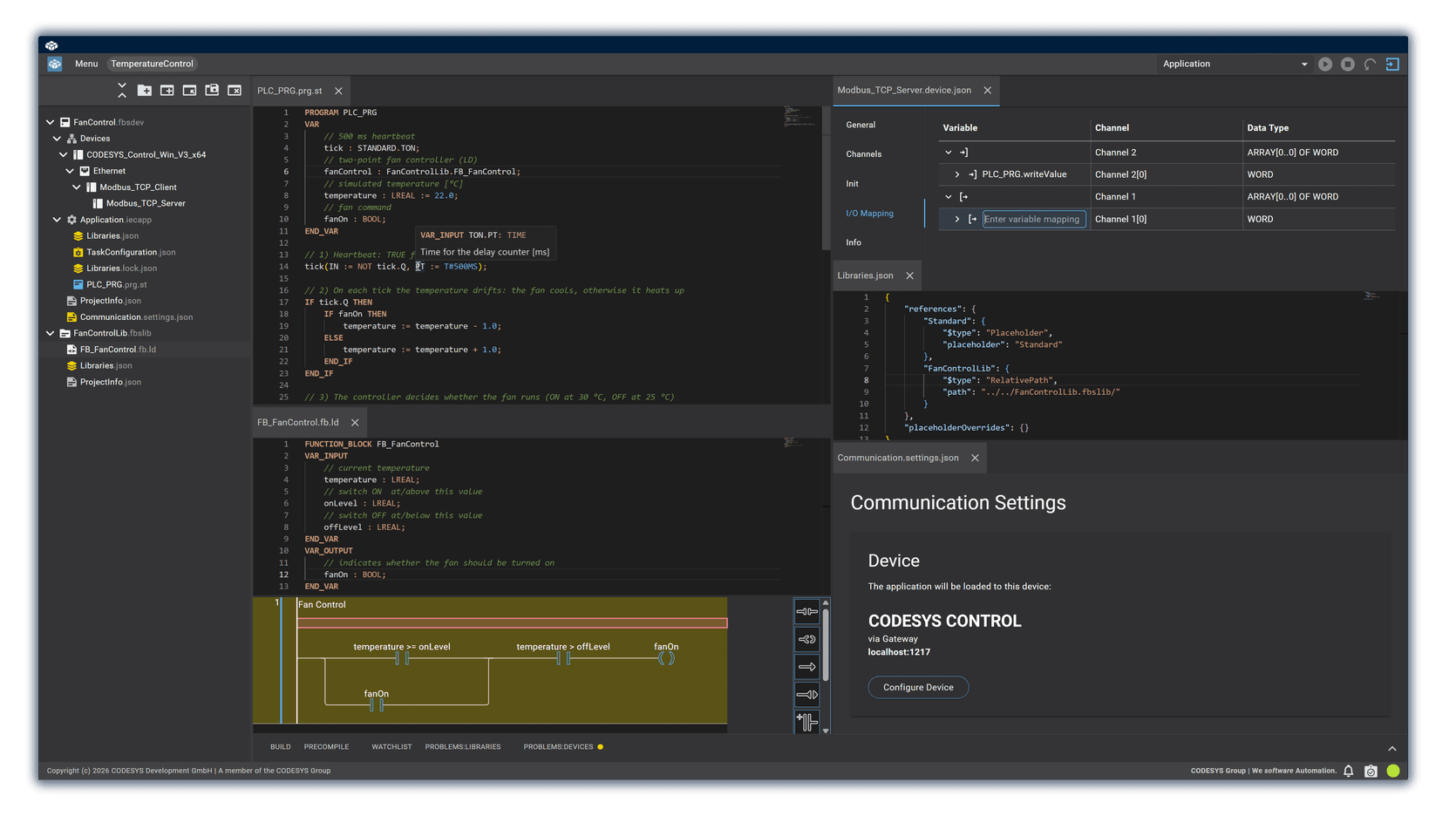

Screenshot of the CODESYS 4 interface: on the left is the project tree with the project's files; on the right is the Structured Text editor with color-coded syntax highlighting.
