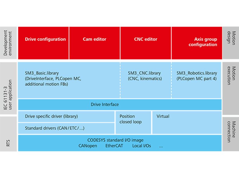

This diagram provides an overview of CODESYS Motion CNC Robotics.

Execution with the PLC
CODESYS executes the motion control in the context of the control application on the PLC. To do this, it abstracts the configured axes as IEC 61131-3 data structures. This means that parameters such as position, speed, and acceleration can be calculated independently of the interface used and the drive system. The specific commanding of the drive system is then performed by an optimized driver. This abstraction allows you to replace the drive system at any time.
PLC and motion control share the same memory area for program code and variables. This means that if the PLC data changes, e.g. because sensors provide new values or there are changed movement parameters from a machine visualization, the movement can also be changed and adapted immediately.
