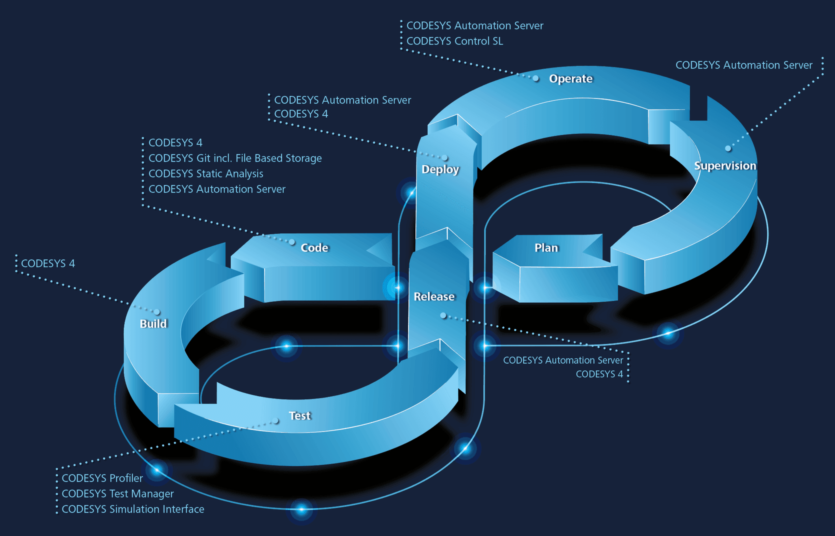

CODESYS 4: The future-proof IEC 61131-3 IDE for you, your team, and your CI/CD pipeline
Same compiler, same runtime system, same libraries. New user interface.
CODESYS 4 is a second programming system alongside the CODESYS Development System 3. You continue to program according to IEC 61131-3, in Structured Text and in Ladder Diagram. What’s new is what lies beneath: The user interface runs in a browser window, the project is stored on the hard drive as a folder containing text files, and the command line is available alongside the user interface.
CODESYS 4 revamps the development environment while retaining the proven foundation. The compiler is the same as in CODESYS 3, the libraries are the same, and the runtime system on the controller remains unchanged. Code compiled by CODESYS 4 therefore runs on any controller that already executes code from CODESYS 3.
CODESYS 4 does not replace CODESYS 3. Both tools will continue to be developed and maintained in parallel. You decide for yourself if and when CODESYS 4 is right for your project. A combination is also possible—for example, developing in CODESYS 4 and commissioning in the CODESYS Development System 3.
CODESYS 4 takes over the features of the CODESYS Development System 3 step by step, so its feature set is intentionally limited. Productive work is possible in two use cases:

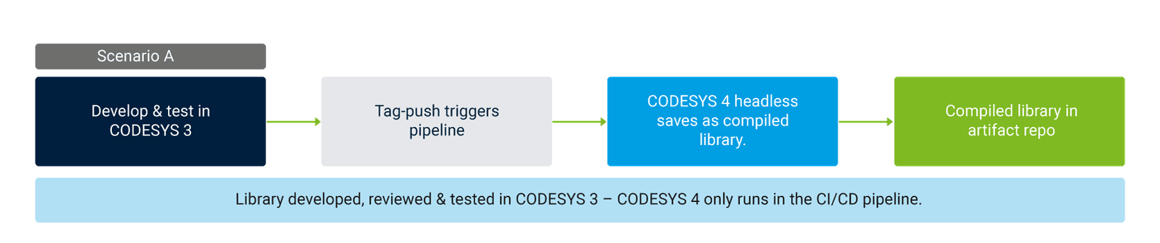

Scenario A: the small step
You will continue to develop, check, and test the library in CODESYS 3, just as you do today. CODESYS 4 is used only in the automated build process. This will not change anything about your day-to-day work.

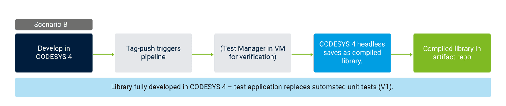

Scenario B, fully implemented in CODESYS 4
You develop the library directly in CODESYS 4. CODESYS 4 does not include automated unit tests, so a test application is used for functional testing: a second CODESYS 4 project that integrates the library and is run manually. The CODESYS Test Manager needs the CODESYS Development System 3, on Linux in a virtual machine.

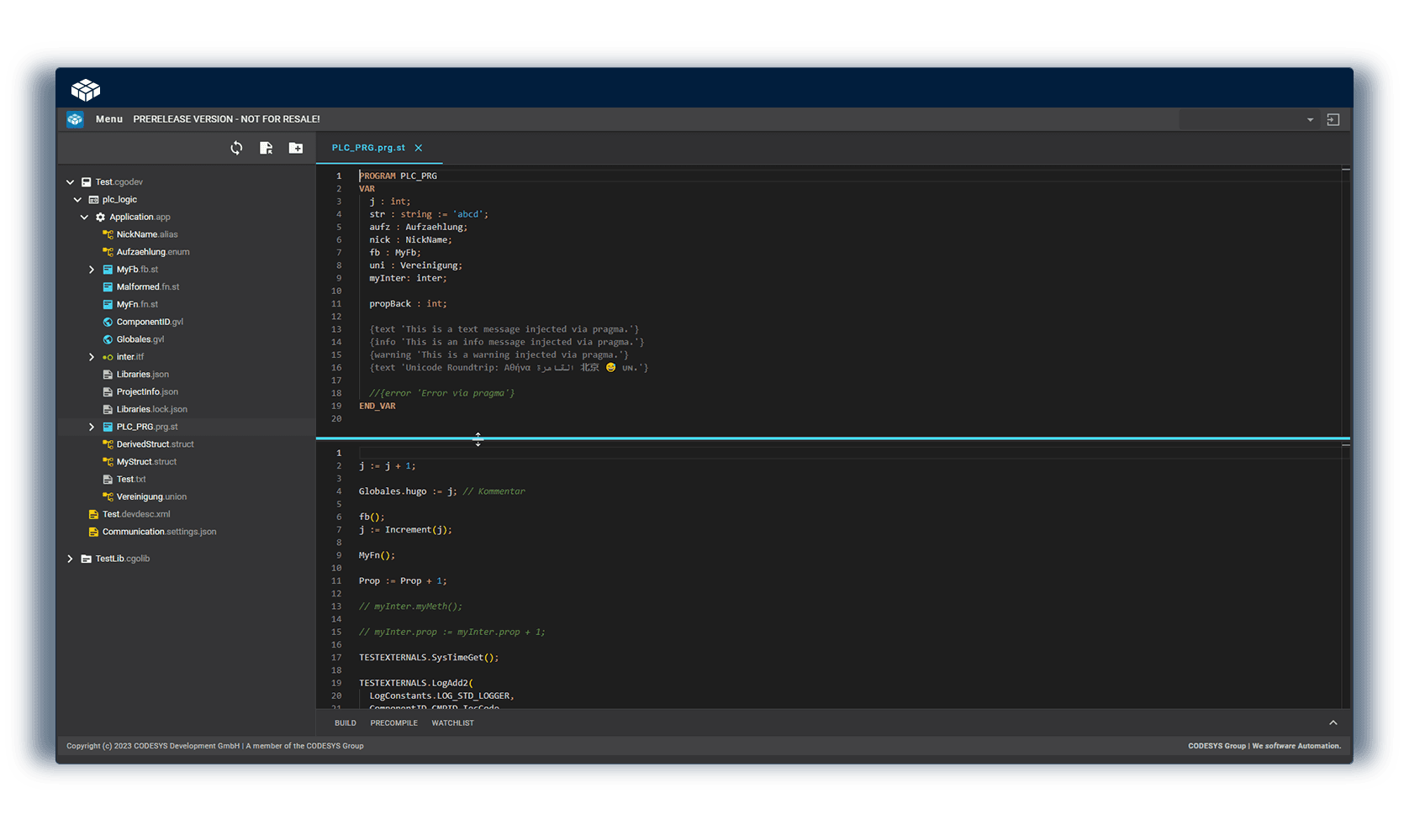

  • Structured Text editor with syntax highlighting, auto-completion, and tooltips when hovering with the mouse
  • Ladder editor, version 0.1, with basic offline functions, based on the graphical editor from CODESYS 3
  • Monitor variable values directly in the line in the Structured Text editor.

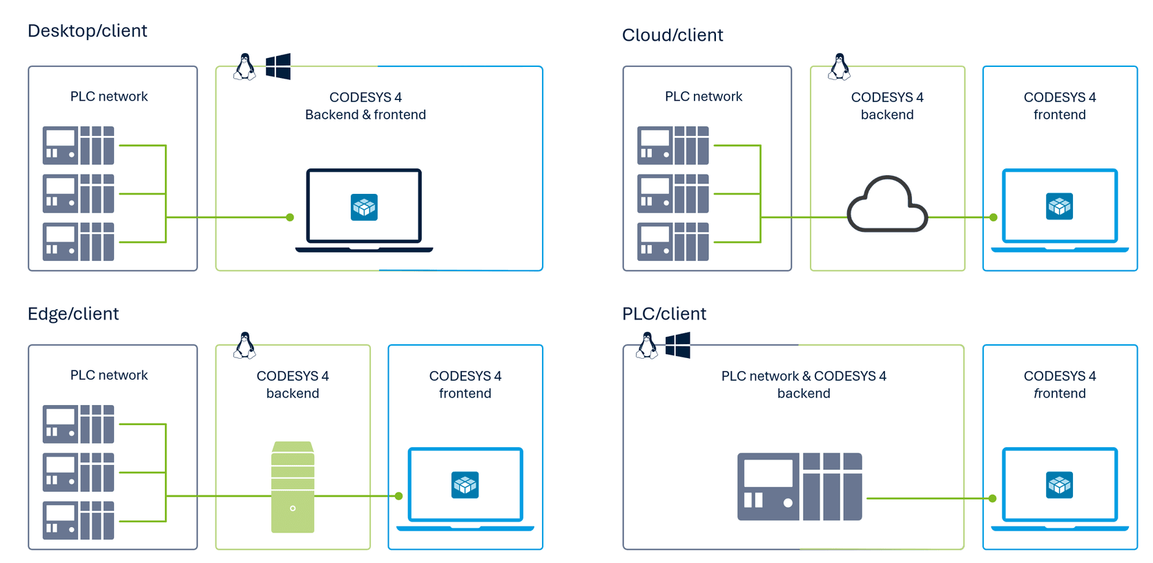

Operating modes and platforms
Single-user mode under Windows
Windows x64, installation via an .msi file. CODESYS 4 launches in its own window. A separate browser is not required, nor is an Internet connection.
Single-user mode under Linux
Linux x64 and Linux ARM64; installation via a Debian package. A single command starts a local session, which is accessed through the local browser.
Shared servers for teams
Linux x64 and Linux ARM64. The c4-server manages logins and sessions based on local Linux users and groups and can be integrated with directory services such as LDAP via PAM. Each session runs in its own process. On an ordinary Linux device, such as a Linux industrial PC, the server runs directly on the controller as well.
Automation without a user interface
Windows x64, Linux x64, and Linux ARM64. The command line tool c4-cli starts up to perform a specific task, completes it, and then exits. It can be used manually, from a script, as a scheduled job, or as part of a pipeline. No separate license is required for the computer running the pipeline.
