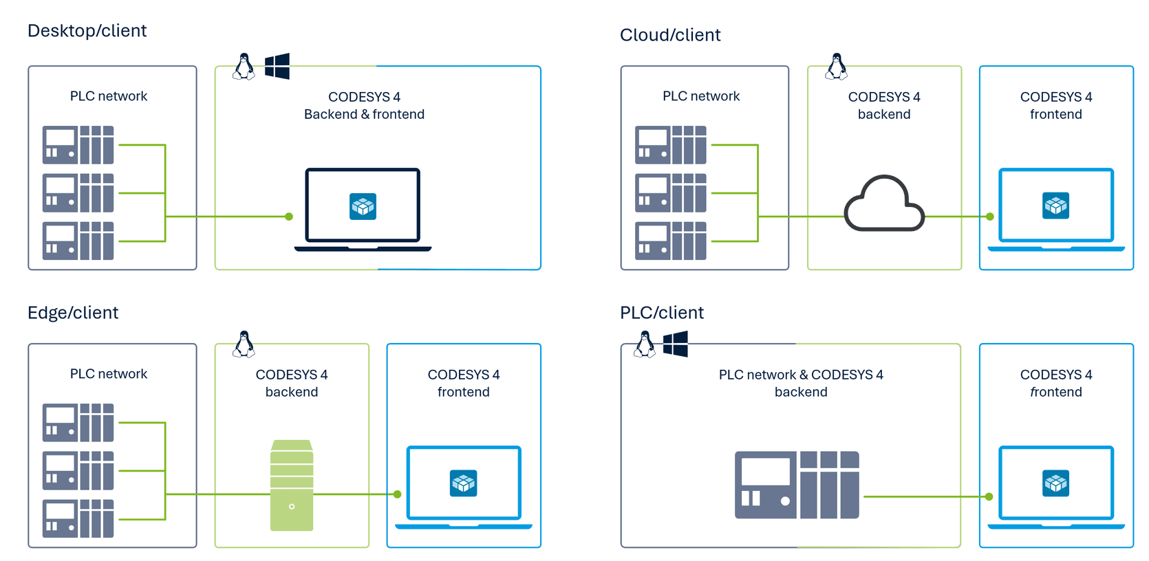

The environment runs on Windows and Linux
Windows x64, Linux x64, and Linux ARM64 are supported without the need for a virtual machine. This means CODESYS 4 can also be run in environments where soft PLCs and virtual controllers are already in use.
The user interface
CODESYS 4 is divided into two parts: A background process handles compilation, project management, and communication with the controller, while the user interface displays the results. On Windows, CODESYS 4 launches in its own window; a separate browser is not required.
CODESYS 4 can also be used without a graphical user interface.
The c4-cli command-line tool is being developed in parallel with the graphical user interface. Using this command, you can, for example, create applications or compiled libraries, as well as set up workspaces, log in to and out of the control system, reset the control system, and much more.
Your project is a folder.
Instead of a single project file, there is a directory containing files in JSON, XML, and text formats. You can examine them, compare their contents using your usual tools, and store them in a version control system such as Git. There is no proprietary binary format.
Teams can work on shared servers.
Under Linux, CODESYS 4 can be deployed centrally. Each user is assigned their own instance running in a separate process. This eliminates the need to maintain individual installations on each workstation, and everyone works with the same version.
German and English, light and dark
The user interface is available in German and English, each with light and dark color schemes. You can access commands via the Command Center using the keyboard, without having to search through the menu.

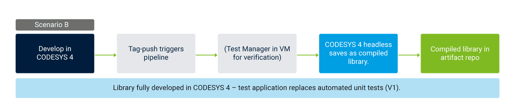

Scenario B, fully implemented in CODESYS 4
You develop the library directly in CODESYS 4. Automated module tests are not yet available in version 1.0.0.0. Instead, a test application is used for functional testing: a second CODESYS 4 project that integrates the library and is run manually. The Test Manager still requires a virtual machine for CODESYS 3.

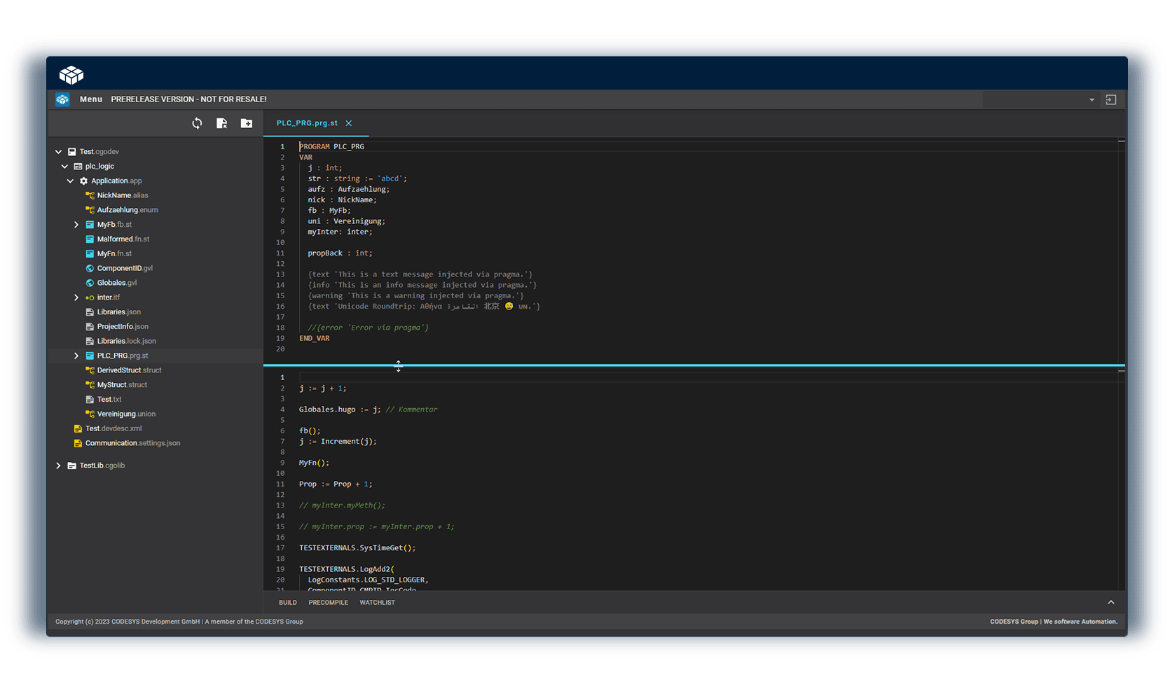

  • Structured Text editor with syntax highlighting, auto-completion, and tooltips when hovering with the mouse
  • Ladder editor, version 0.1, with basic offline functions, based on the graphical editor from CODESYS 3
  • Monitor variable values directly in the line in the Structured Text editor.

Operating modes and platforms

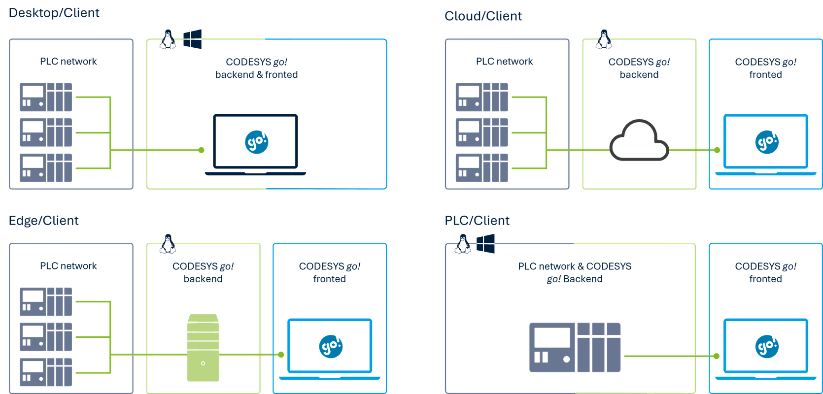

Single-user mode under Windows
Windows x64, installation via an .exe file. CODESYS 4 launches in its own window. A separate browser is not required, nor is an Internet connection.
Single-user mode under Linux
Linux x64 and Linux ARM64; installation via a Debian package. A single command starts a local session, which is accessed through the local browser.
Shared servers for teams
Linux x64 and Linux ARM64. The c4-server manages logins and sessions based on local Linux users and groups and can be integrated with directory services such as LDAP via PAM. Each session runs in its own process. The server can also be run directly on a control system.
Automation without a user interface
Windows x64, Linux x64, and Linux ARM64. The command-line tool c4 starts up to perform a specific task, completes it, and then exits. It can be used manually, from a script, as a scheduled job, or as part of a pipeline. In the first version, no separate license is required for the computer running the pipeline.

System requirements
  • Operating system: Windows x64, Linux x64, or Linux ARM64. Server and device operation require Linux.
  • Browser for operation under Linux and in server mode: a current browser
  • Controller: CODESYS runtime system, Service Pack 19 or later; see list above
  • Connection to the controller via CODESYS Gateway, version 3.5 or later
  • An Internet connection is not required for operation
