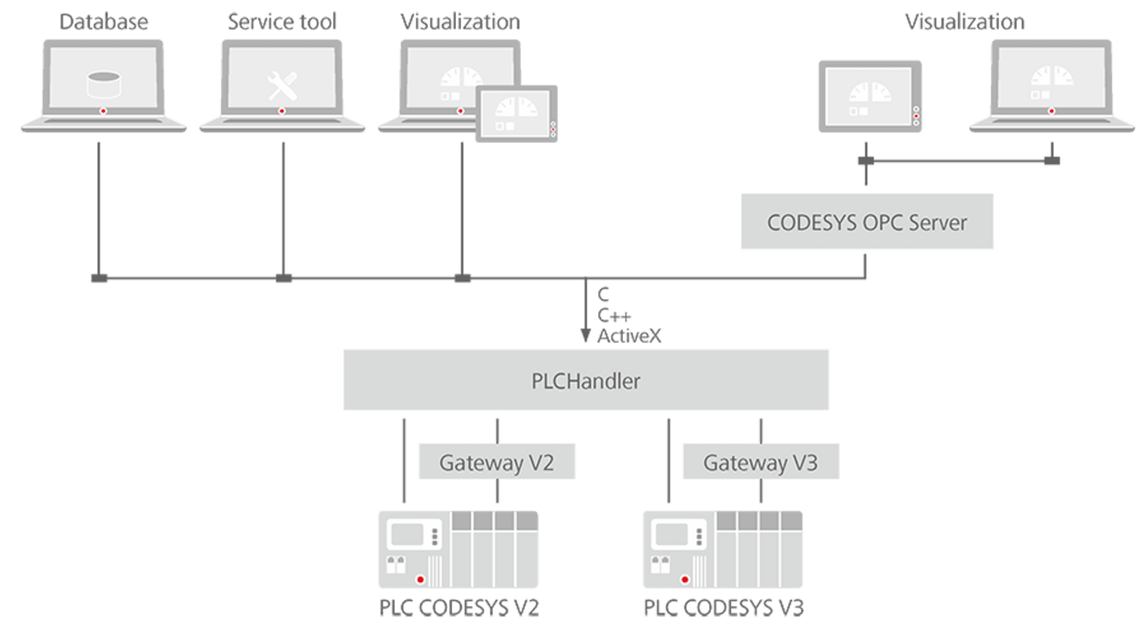

The CODESYS PLCHandler is an easy-to-use software interface (API) for the communication between CODESYS controllers and external client systems. An external client like a visualization or a service panel can access the IEC 61131-3 variables and the online services of the controller using this API.
Functionality of the CODESYS PLCHandler (excerpt)
  • Establishing or terminating a controller connection
  • Reading the variable list of the controller
  • Cyclical reading of variable values from the controller
  • Synchronous exchange of variable values (read/write) with the controller
  • Instantiability for the simultaneous communication with several controllers
  • Automatic reconnection to the controller after connection failure
  • Automatic reconnection after a program download from CODESYS to the controller
  • Transfer of data to and from the controller
  • Callback functions for different events
The CODESYS PLCHandler has been implemented as a C++ class and is delivered in form of a Software Development Kit (SDK). Above that, the PLCHandler also offers a plain C interface and is available as an ActiveX component for Microsoft Windows. Apart from platform-specific files for example for Windows, Linux® or VxWorks® the SDK also contains trial clients in source code for different platforms.
